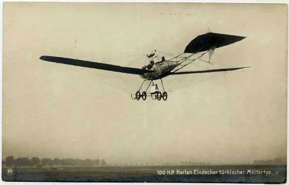

Due to the date of manufacture I have some doubts as to my choice, but it does not hurt to try.
Judging by the look of the chassis, the shape of the wing and the arrangement of tail section this may be Harlan Eindecker.
The machine was constructed in 1911. It was two-seater, reconnaissance monoplane. Two of these planes were purchased by Ottoman Empire from Germany among with the other monoplanes in 1911. During the Balkan War both of the planes which were sent to the front were captured by the advancing Bulgarian Forces.
Unfortunately, I do not have any information on the use of the airplane in 1914 or later.

Hello again,
Here is some additional information about the aircraft. During National Week at Johannisthal a pilot Grulich flying the Harlan Eindecker, was third in the duration of flight competition. His flight lasted 10 hours 10 minutes.
The same pilot in the aircraft set a new record in January 1912. With two passengers on board he succeeded in keeping up for 2 hours 2 minutes 45 seconds.

Hmmm, no other entries after 12 hours...
Marek, you are not far from the goal!
Just there is something missing till now.
It is not the 1911 Harlan.
And the type briefly flew in 1914.
(but you are right, it is a pre-war design)
I will come back to the records later, but I have to ask where you get your notes from?
When did Grulich flew 10 hours?
Following Günther Schmitt, the time record with pilot only was 5:10 h on December 12th 1912, set by Alfred Friedrich and Felix Laitsch flew 9:23 h on Oktober 28th 1913.
The "National Week" you mentioned was the "Nationale Flugwoche" in June 1911, when Grulich won the highest price? There have been two earlier ones in August and Oktober 1910, but Karl Grulich didn't took part then.
The achievements of the aircraft I'm looking for where reached by other pilots.

Harlan had a 1912 2-seater eindecker with 100 hp Argus engine, flown in 1912 by Ernst Kruger in the "round Berlin" flight of 1912, which he won. This would appear to be it.
"Den Wettbewerb »Rund um Berlin« gewann Ernst Krüger (Harlan-Eindecker, Flugpreis: 26 836 Mark) vor Anton Baierlein (Otto-Zweidecker, Flugpreis 18 810 Mark) und Karl Caspar (Rumpler-Taube, Flugpreis: 8 613 Mark)"
Forgot to add that the cockpit arrangement and fuselage are more in keeping with the 1912 version.

There is "Harlan military monoplane of 1912" mentioned in Janes 1913. Photos of this macine seen in Flight, 1912.

You are right. The problem is that I have information only about Harlan monoplane itself, that is - on the original design of 1911. Of course, I realized that the fuselage of early model of the aircraft was not covered. However, this was the only difference that I could see.
The main source about the airplane, which I used is here.
BRISTOL Pre WW I Period TUAF AIRCRAFTS 1 nci dunya savasi oncesi Turk HvKK UCAKLARI
As to Nationale Flugwoche in 1911, I was suggested by the press release. Pay attention to the note entitled The Johannisthal Meeting.

Lodzermensch is right about "Harlan Eindecker" but not 1911 version.
There was Harlan Pfeiltaube in early 1912, which is not the case too.
Harlan Eindecker, Militärtyp 1913 should be the case now. The story is a bit complex, as shown below.
Peter Supf, Das Buch der Deutschen Fluggeschichte: Vorzeit - Werdezeit - Wendezeit (1956) S.526
Dr. Wolfgang Harlan mußte im Januar 1913 seine Werke schließen; sie wurden später als Bussard-Werke forgeführt. Harlans tüchtiger Konstrukteur, Karl Grulich, trat als Chefingenieur bei der Gothaer Waggonfabrik ein.
People involved with the machine of this Challenge are, obviously, Dr. Wolfgang Harlan and Karl Grulich, and probably Max Schüler.
Max Schüler set an enfurance record of 9 hours 45 minutes on February 9, 1914.
Hermann Reichelt flew Harlan aeroplane(s) on long distance flights during 1913 (Kiel-Posen 500 km in July; Berlin-Paris 1025 km in September).

Thanks Yavor for the additional info. However, I must admit that I am more and more confused. Name Pfeiltaube suggests that there was yet another type of Harlan monoplane. Maybe I am wrong, but for me Taube means the characteristic shape of the wing.
Can somebody list all types of Harlan monoplanes, as listed in the books?
Here is the airplane mentioned in my first post

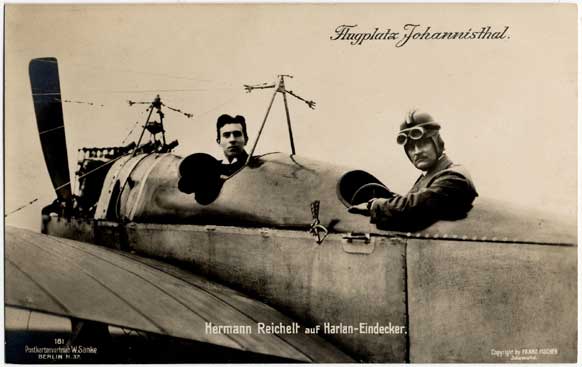

And here you have another one, later type I guess
Old 1 March 2009, 03:06 AM   #10 (permalink)
Posts: 2,392
Hi Marek,
This is Reichelt's aeroplane, I think.
Yes, Pfeiltaube is a true Taube according to the picture in Supf, Bd.2.
