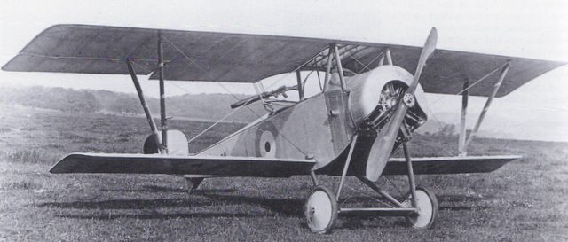

This one looks like the earlier model of Nieuport 12 – it is distinguished by semicircular (or horseshoe if you like) cowling. Sesquiplane layout, V-shaped interplane struts which were not parallel as distinct from Nieuport 10, Clarget engine, celluloid panel above pilot’s post and Étévé gun mounting are another characteristic features of this type.

It looks like the Siemens-Schuckert D.I "Stretch Limo" version!
HAPPY TRAILS, FOKKERJ
P.S. Then again, it could be a Nieuport 10 with the "Horse Shoe" shaped cowl versus the Ni. 12 with either that or the fully round cowl.

I don't know much about french aircraft ,so I must rely on the ID of the picture, and my book says : Marek is right .More it's clearly not a single seater : it's not a Nieuport 10 ,but Nieuport 12 two seater .

Thanks Fellows. I think some inaccuracy must have been explained here.
Richard,
Actually Nieuport 10 was not a single-seater or I have omitted something reading my books.
In fact, the most visible difference between N.10 and N.12 was the outward rake of interplane struts and the arrangement of the armament in the latter.
In conclusion – here is a photo of Nieuport 12 produced by Beardmore. This picture is published in Nieuport Aircraft of World War One by Ray Sanger – an excellent and comprehensive source of information on Nieuports. There are neither drawings nor color profiles so revered by modelers but the book is full of brilliant photos printed in high quality.

What am I missing?
Richard,
Thanks Marek.
Help me.... I don't see the difference between these two machines(?).
Cheers, FOKKERJ
OK, OK.... Yes, I see that one has Eisenkreuse, no machine gun for the Observer, and the tailskid is about a meter off of the earth!

I haven't seen another picture of a 10 with that type of transparent cut-out in the top wing, but it is quite typical of the 12. Is Fokkerj's picture correctly identified or did some 10's also have that feature?
Gentlemen,
Both pictures show the same type - an early Nieuport 12. That is why there is no difference between them. Sorry if I did not clear up this in my previous post.

My source was William Green's book about fighters of the world .
In fact ,I didn't read it carefully enough
For Green , Ni 10 was at first two seater and later single seater.
The outward rake of the interplane struts is well illustrated in the 3-views .
Thanks for the info .

Hello ..Look again at the photos of the two aircraft close together ...I would say that the lower one ( in British markings ) ..has for its lower wings , a slightly longer ( by one rib bay ) overhang , outboard of the interplane strut attachment point than the machine in German markings ....
What do you all see here ? JM
