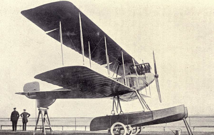

I have few postcard in my collection, among them is this german seaplane.
Do You know what type is it, or maybe it's just an artists fantasy.
It was written to "Dear Friend" in 1917.
Thanks!

It is not a fantasy but more an artist impression of an actual early German floatplane, the Friedrichshafen FF 29. It is an approximation ....
Look at these actual pictures

Looks like it,
thank You very much Kees!

To me it looks the artist forgot about a second float and the rudder differs a bit. No stabilizer to recognise. Just the all-over appearance makes it definitely a Friedrichshafen and the side radiators qualify it for the FF 29.

I just stumbeled over a picture of a 1914 Albatros Wasser-Doppeldecker, which I believe might have been the pattern for that drawing.
If I'm not mistaken this Albatros water-biplane with tailfloat predates the Albatros W-series. The W.1 (B.IIw) and the 3-bay B.Iw did not had a tailfloat. Can this possibly be the one Albatros has send to Monaco before the war? Would be glad if someone can state more about.
I must admit the tailfloat design is a big lead to Friedrichshafen.
But compare the details given - Float design, tail construction, engine installation and centre-strut mounting...
The picture comes from Photos of The Great War - Information
Aquilius

You are right, IMO this Albatros WDD is a better candidate for the drawing WDD stood for Wasser Doppel Decker. A text on this picture presented as a postcard gives Albatros Marine Doppeldecker. Characteristic is the form of the rudder, rather 'un'-Albatros like. Later they reverted to other rudder forms.
Monaco ?
These are pictures of the Albatros floatplane participating in Monaco 1914. This is another floatplane than the Albatros WDD.
It is little known but there was also also a single-float early Albatros floatplane (Zentralschwimmer). Although the picture is heavily mutilated it is interesting to have a look at it ...
So you see, someone who wants to write a history of Albatros (or of the floatplanes alone) will have a lot of research to do. Probably all Albatros archives have disappeared into limbo, so ....

Well Friends, You've done it!
Match.
