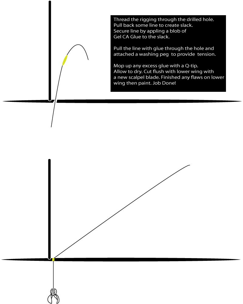

One question I have about rigging is how to "finish" the rigging. OK, so you drill part-way through the upper wing, and either insert Bob's eyelets or just glue the wire in there. After drilling all the way through the lower wing, and threading the monofilament through, you tension it by hanging a haemostat or similar from it. Now comes the tricky bit. How do we secure the line?
I gather it would be better to glue it on the underside of the lower wing (as it would be less visible there), and then slice the line off as close as possible, and even add a drop of paint to cover up the hole.
But the underside of the lower wing is, well, upside down. How does one glue here?
I was even thinking of assembling the rigging upside down, then running the line through the lower wing, and over some kind of upright, and hanging the stretched line and the weighted haemostat dangling down, enabling the line to be glued with no problems.
Can anyone understand that? If you can give me any tips on how to do this, I'd be grateful.
13 January 2010, 03:43 AM
#68 (permalink)
Location: England
Posts: 1,444
Hi Steve,
I hope my basic illustration helps.
BVB

It's the touching up of the holed wings that bothers me. The way I visualise doing things, there's going to be some weathering that will also need touching up...might need to rethink it.
Thanks for the diagram Bob.

Bob,
As always, very informative, very helpful, and great illustrations. Thanks a lot mate. (There, I used it Nick. can I belong to the "mate" club too? Oh. I'm an Aussie born and bred...guess I always WAS a member [didn't even have to go so far as saying "Crikey! Stone the flamin' crows! Youse shielas are grouse!").
Sorry for that.
Anyway Bob, I appreciate your assistance.
