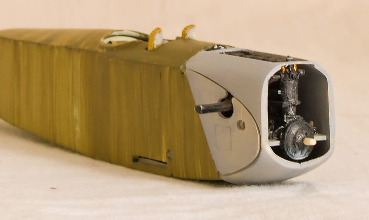

The cockpit fitted reasonably well in the fuselage, though I’ve read about major problems to this. I cut and filed a little on the bulkheads, and inside it slipped. The resin engine is a gem, but there’s nothing to fix it to, so I produced a couple of frames for it, calculated the height and fastened them to the inner side of the engine compartment.

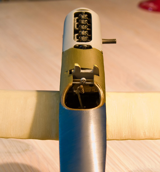

Next, the fuselage halves assembled. The sides of the engine compartment have given me some sleepless nights. Should I use the ones supplied in the kit or make some new ones? After some time I finally chose to use the ones from the kit. I’m still not certain, though.
Lots of filler required, because the material is so soft. Once you have filled and sanded down the assembly lines on the upper and lower fuselage, the filler material will sink. One more treatment. And one more. Also the division on the nose panels to the fuselage sides requires some filling. These panels are made like their smaller counterparts from Roden and Eduard as one large panel, in order to give us a choise of putting the ones from the late built Fokker on. This means, that on this early built there’s a division going from the top corner down to the leading edge of the lower wing. On the early built Fokkers, the resulting rear triangle was linen covered, hence the filling here.
On Berthold’s plane, the area from the red engine compartment to the middle of the cockpit had kept the olive streaking. This I did as I did on my DrI.
This is described on my thread:
Roden 1/32 DrI at last
The back of the fuselage was blue painted on over the streaked olive, so I did it here as well, only just one layer in a faint hope that it would be a little bit visible under the blue.
The engine is seen securely fixed to the two structures on the inner side on the next.
More to follow....

The top of the engine compartment consisted of one, sharp-cornered rectangular opening. Some additional plating must be made, both in the front and rear ends.

Next, the rear fuselage was equipped with the underlying decal and painted blue. I have studied the profile of this machine in the “Fokker Anthology 1” intensively, trying to catch a little bit of transparency to the blue. One coat was too little, so two coats it was, making this look quite like the profile. No traces of the streaking, though.
The etched dashboard supplied by Battle Axe is really beautiful. I put a couple of spare instruments on it.
More filler required on the lower part of the engine cowling. The kit has a division at the bottom, which isn’t on the plane.
More to follow in a couple of days.....
