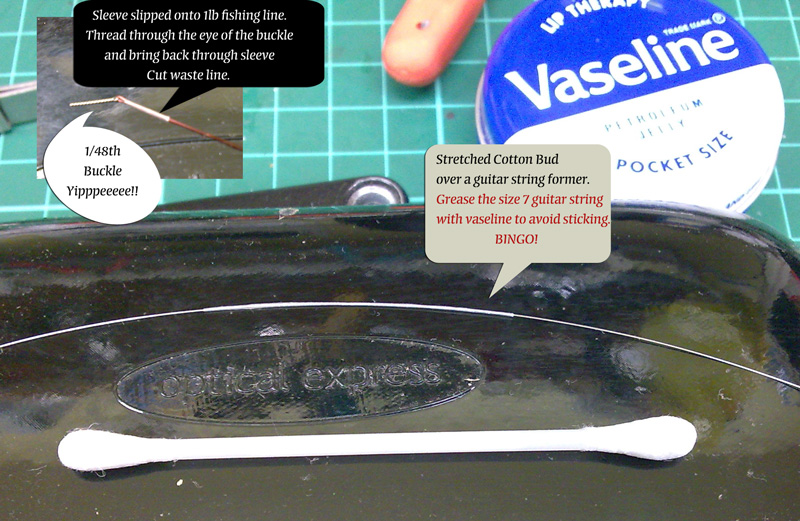

The picture below shows you how I create regular sized sleeving for use with wire buckles. This method comes into its own for the smaller scale WW1 aircraft or when fine brass tubing is hard to come by. This method can also be upscaled for 32nd using size 9 guitar wire as the former.
This method makes it possible to make up all your rigging runs before applying them to the model.
Happy days!
Von buckle Smiley
P.S. I show this as a method and not as a sales pitch for my product.

I have been using this technique for many years, but I do not find a need to grease the mandrel wire. I use Contrail plastic tubing and the plastic just slips right off. I find that if I pull the mandrel wire straight before heating and streaching the plastic the results are better. I clamp one end of the mandrel in my bench vice and grip the other end with a vice-grips pliers which I clamp to my workbench with a C clamp. I take the mandrel wire out of my jig and cut the pieces of stretched plastic right on the wire by rolling a #11 xacto blade on the plastic. I use the part of the blade nearest the handle so as not to dull the tip area, which I use for 98% of my other cutting. YMMV.
