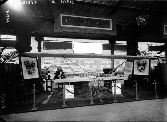

May be the "Aviette" piloted by Poulain on 9 july 1921
He won the Peugeot contest (10000 F) with this strange bicyclette/bi-plane
ClaudeL - Vlo vole ?

My idea too , but here , it is seen during a later exhibition (Salon de l'aéronautique au Grand Palais ?)...

As still can be seen in the somewhat doctored picture, the machine won the Peugeot 1921 contest.
THE PEUGEOT PRIZE
In 1912, Robert Peugeot of France offered a prize for the first flight of a distance of 10 metres (33 feet). There were many attempts at this, and Peugeot gave several consolation prizes, some of them for distances less than the long-jump record of the time which was 7.61 metres,(Peter O'Connor in Dublin, 5 Aug 1901), but the prize was not won for nine years. .
POULAIN/FARMAN
A machine was built by the Farman company and pedalled by Gabriel Poulain over the specified distance in both directions early on the morning of 9th July 1921 with Robert Peugeot watching, with a distance of 11.98 metres. (Incidentally, two weeks later, the long-jump record was reset at 7.69 metres by Edwin Gourdin on 23rd July 1921 in Cambridge Massachusetts. ) The Poulain Farman machine was undoubtedly a human-powered-vehicle. It was a biplane with a span of 20 feet (6 m) and a wing-area of 132 square feet,(12.08 m2) (i.e. larger than some wings built for the purpose of true human powered flight in the 1960's). There was a fairing around the person and bicycle. There was no propeller and there were apparently no aerodynamic controls. The total weight was 201 lbs.(91 Kg)
Source:
MUSCLE ASSISTED FLIGHTS BEFORE 1939
The original picture unadorned can be seen in the files of the BNF
Salon de l'Aéronautique : Stand Peugeot (Aviette de Poulain) : [photographie de presse] / Agence Meurisse
According to the description of this Meurisse press picture the picture was taken on the Salon de l'Aéronautique : Stand Peugeot (Aviette de Poulain) in 1921. I have not checked if reports of the 1921 Salon gives information that the Aviette of Poulain (Farman built) was exhibited.
Tork1945

Correct identification
The human-powered Farman-Poulain aviette which won the Peugeot prize on July 9th, 1921.
