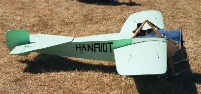

Sorry Eric,
I don't have any info to help you out. How about some Hanriot eye-candy as a consolation?
This photo doesn't really do this 1/4 scale model justice.
