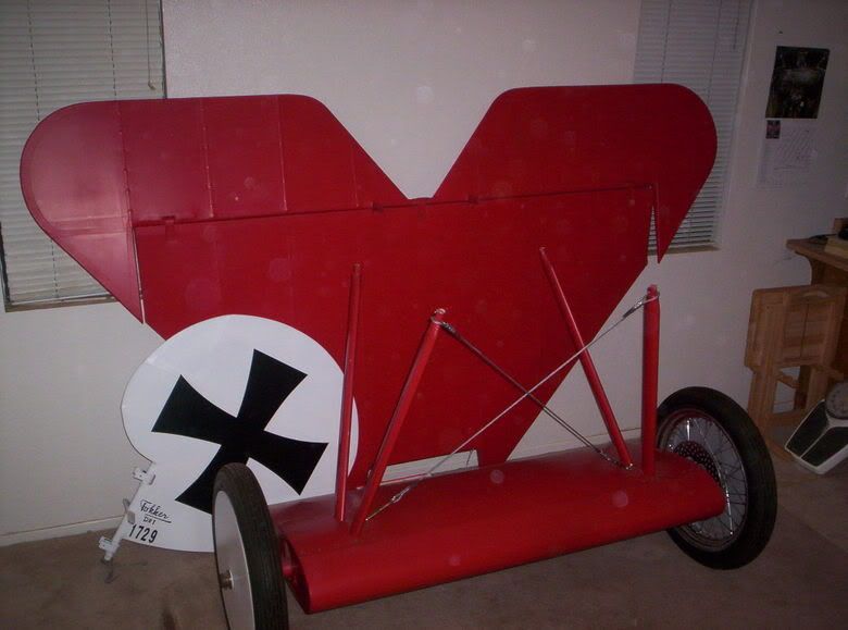

By the way, I am using the 2.7 oz fabric from Poly-fiber. I checked last night when I was working on a patch for the aft fuselage. The small parts used on the a/c, I either manufacture or I have a local machinist do the work. By the way, never trust someone to do the work for you. Most local types have no clue what "aircraft quality" is!
Also, to those gents who frequent this forum ; take everything anyone says here with a grain of salt. Don't go off and try something just because someone suggests it...including myself. Do your research. Join an EAA chapter, and find a mentor if you have no experience with building an a/c or aviation. I have run accross so many knucklheads who are content to run down to the local hardware store for their construction needs!
Also, don't EVEN attempt to start welding until you know what you are doing and understand metallurgy. I have read quite a number of comments here made by well meaning individuals that just makes me cringe!
Also, the DR1 has a lot of room for improvements that will never show on the outside. As an example ; save your money on turnbuckles! You can always use tubing cross bracing for the fuselage. I recall that mine is 5/8 x .35 wall. Many Dr1s have this modification including my own. The other advantage is you don't have to "re-tune" the fuselage when the .090 bracing wires stretch.
Other mods ; tapered flanges. Years ago I went to Chuck Wentworths hanger to discuss his Dr1 and its construction with him. He pointed out on my plans that the use of tapered flanges and the variable sized blocks that are within the spars are a royal pain in the arse to make, and completely a waste of time. The Germans apparently were trying to save wood, and the savings in weight is not worth the effort. Not only was his tripe made this way, but so are others. Mine is too. So much easier to manufacture the spars. But again, don't take my word for it. Do your research.
Here is a group shot of the horizontal stab, rudder, and gear..all completed.
I moved them into my living room because I was spray painting the fuselage. And don't worry..no wife to bitch about plane parts in the house!
[IMG][/IMG]
